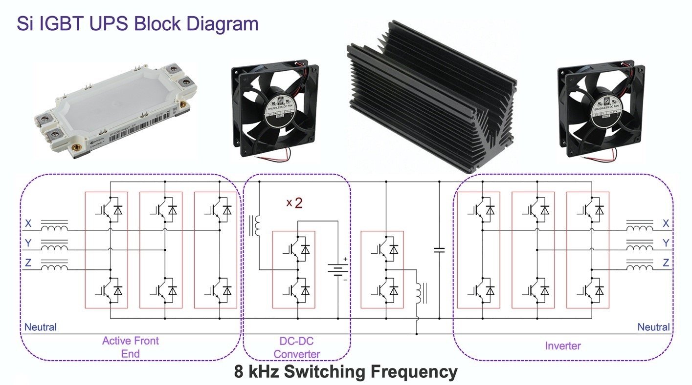

A best-in-class silicon IGBT-based design (Figure 2) uses power modules switching at 8 kHz to maximize the tradeoff between system size and system losses. The modules need a heat sink and pusher and puller fans to generate enough airflow for managing system heat.
The losses per module in the AFE run up to 1.1 kW, with IGBTs and diode junction temperatures (Tj) reaching 130°C and 140°C, respectively, at a case temperature (Tc) of 40°C. The design requires 6.4 L of heat-sink-and-fan volume to dissipate that much power.
Figure 2: The IGBT-based design requires a large heat sink and two fans for each module.
For the DC/DC converter, the losses are about 590 W per module. While diode Tj is lower at 75°C, the IGBT Tj rises to 136°C. The DC/DC converter not only needs 3 L of heat-sink-and-fan but 1.9 L of a 100-μH inductor using up 182 W as well as 3.6 L of 2.32 mF in electrolytic capacitors.

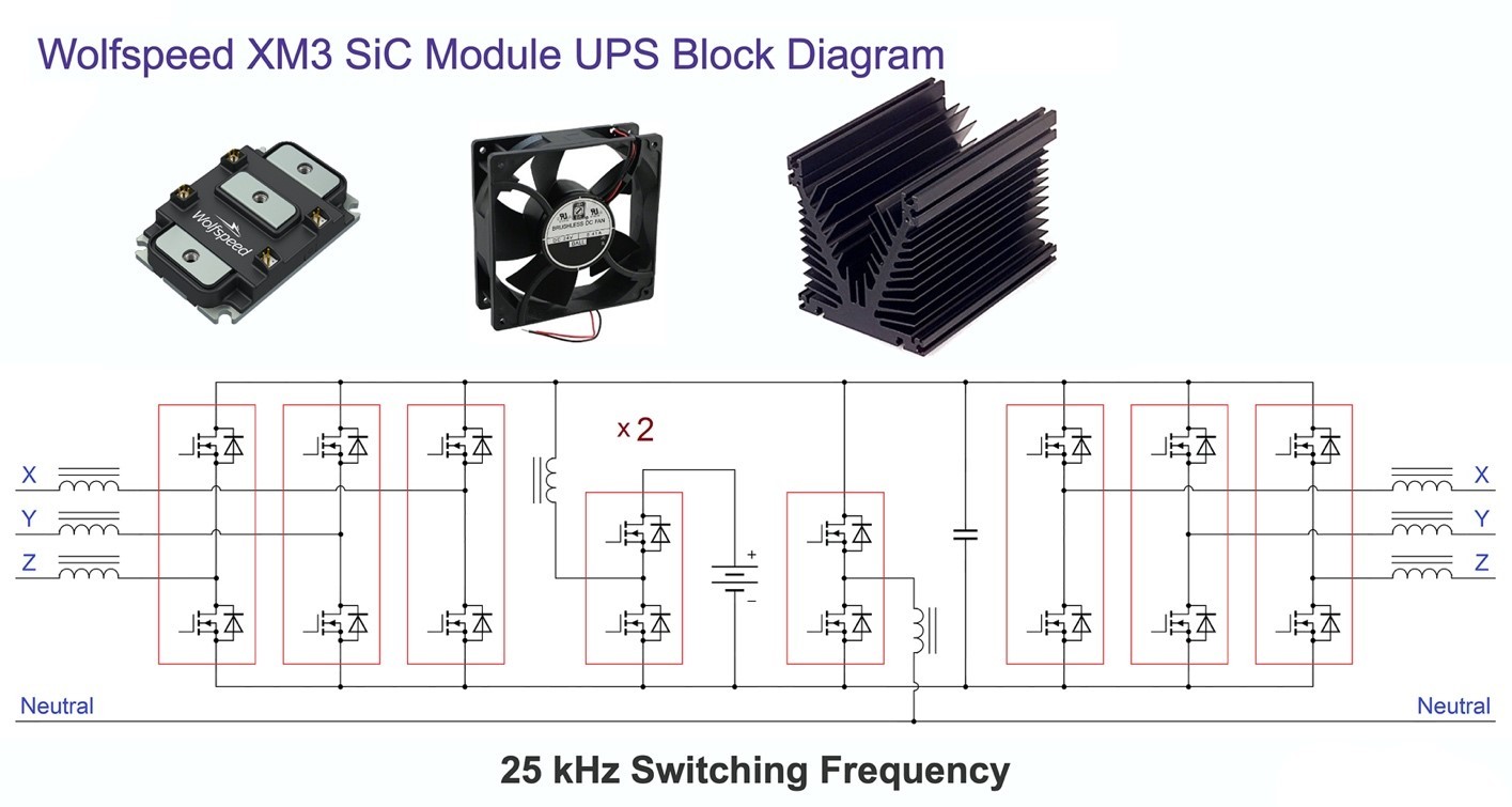

SiC power modules can be used in the same topology (Figure 3) and, with some optimization, take the switching frequency to 25 kHz and deliver compelling benefits:
  • The SiC-based AFE losses per module come down to a mere 662 W.
  • Rated as high as 175°C, the SiC modules can run hotter and reach a Tj of 164°C @ Tc 40°C.
  • Because the SiC MOSFET integrates a body diode, the modules do not require additional diodes and are therefore smaller.
  • With the modules running hotter and system losses significantly lower, a smaller heat sink with only one fan is required for heat management. This takes down the cooling system volume for each module to 3.7 L.
A major benefit of using SiC in a DC/DC converter is the capability of using synchronous switching, where most IGBTs are at a disadvantage, as they cannot conduct in the third quadrant. SiC, instead of using a diode, uses the MOSFET channel in the reverse direction and decreases conduction losses in the system. The converter therefore offers the following benefits
  • A much lower single-module power loss of 284 W
  • An allowable higher MOSFET Tj of 143°C @ Tc 40°C
  • Cooling system volume of just 1.9 L
  • Dramatic reduction in inductor requirement to 1.2 L of 30 μH consuming 137 W
  • Higher frequency that translates to significant savings in capacitance at 1.2 L of 740 μF in film capacitors that also help increase system reliability/lifetime over electrolytic capacitors
