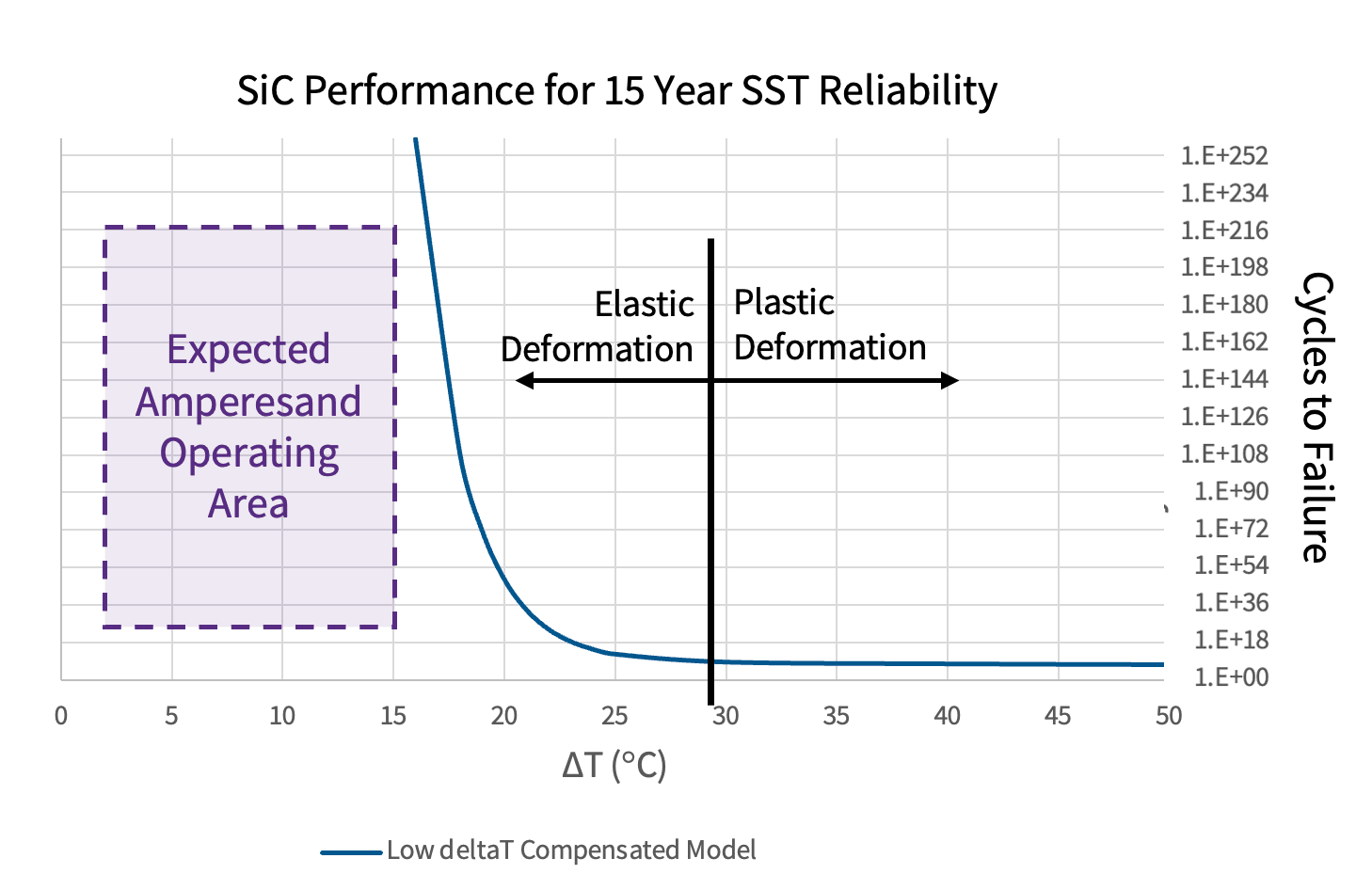

    The early partnership began crystallizing when Amperesand approached the Wolfspeed reliability and applications team to understand the SiC lifetime against emerging AI power cycling profiles. Amperesand provided a variety of critical power mission profile scenarios, including AI training workload conditions as jointly released by NVIDIA, Open AI and Microsoft1, and Wolfspeed got to work developing extensive mission profile lifetime analysis.
    Figure 1: Anticipated power cycles to failure are near infinite
    Wolfspeed’s new 3.3 kV module includes epoxy encapsulation for added mechanical stability. Based on the failure criteria Amperesand provided to Wolfspeed and as shown in the chart above, the SiC in the Amperesand SST achieves a near infinite lifetime due to low ΔT (<30°C), enabled by a highly innovative liquid-based cooling system that unlocks 50º C+ ambient operation to support AI factory critical power in any environment. Wolfspeed’s epoxy-filled package achieves a 5X improvement in power cycling performance over standard silicone gel encapsulated modules.
