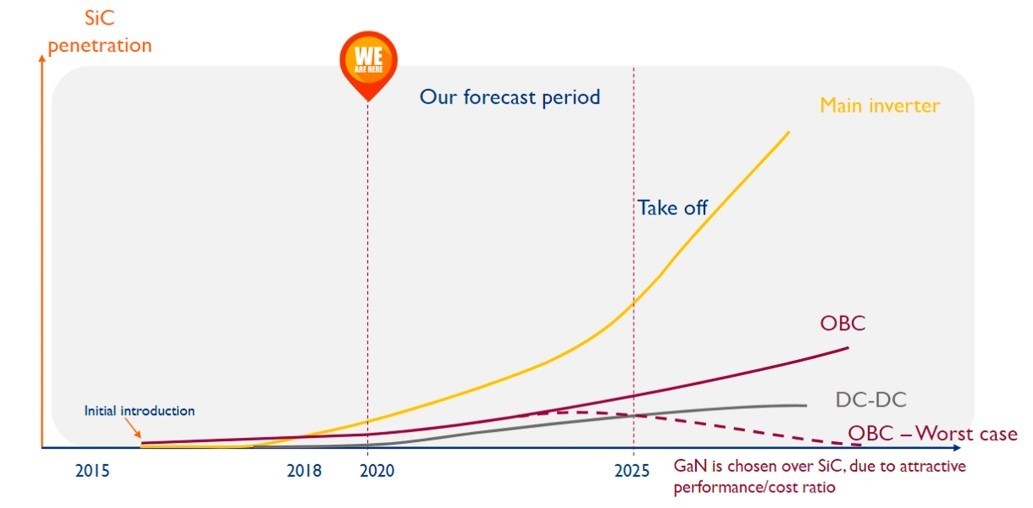

A simplified line graph of what Yole Devéloppement predicts of the electric vehicle and hybrid electric vehicle market.
Figure 1: EV/HEV market outlook to 2030. Source: Power SiC Materials, Devices and Applications, Yole Devéloppement.
Yole Devéloppement forecasts the EV market the biggest opportunity for SiC, worth over $5 billion in 2027, while the charging infrastructure market continues growing at 90% CAGR through 2025. Yole expects SiC to gain market share in the long term as companies like Wolfspeed overcome all challenges, including those related to supply, cost, and performance (Figure 1).

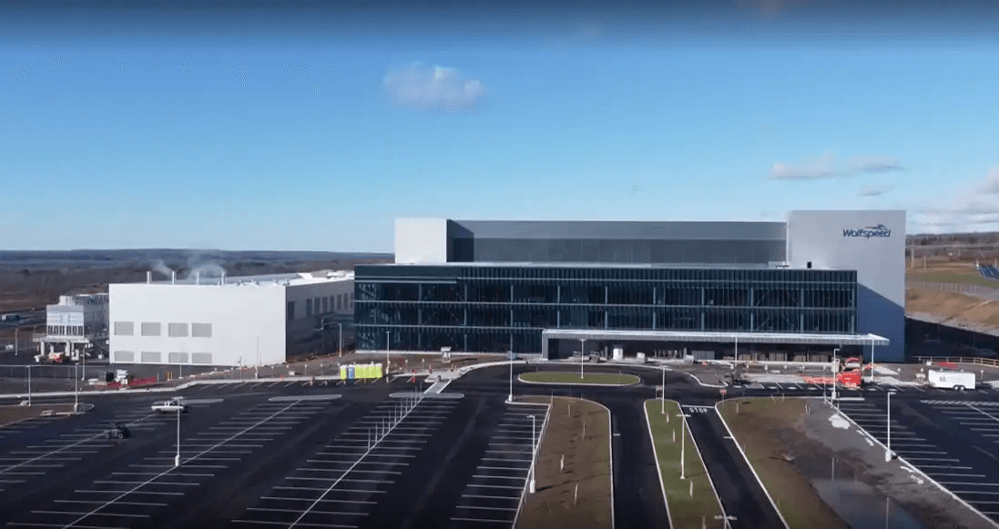

The MVF construction is complete, the first 200-mm wafers demonstrated, and the fab is undergoing qualification for mass production.
Landscape photo of the new Mohawk Valley Factory. You can see the whole building as well as the parking lot. This photo was taken shortly after the construction was completed.
Figure 2: Wolfspeed is leading the industry in taking 200-mm Silicon Carbide wafers from prototype to production. The new Mohawk Valley Factory fabrication facility is shown above.

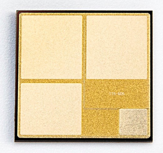

Macro photo of the new Gen 3+ 750V MOSFET.
Figure 3: The Gen 3+ 750 V MOSFET sets new standards for low RDS(ON) and temperature qualification.

Wolfspeed has continued innovation to address these concerns with a new Gen 3+ 750 V bare-die MOSFET (Figure 3) that has already won several contracts. Coming in a 5mm x 5mm-layout and 180-mm thickness, it features low internal gate resistance Rg to optimize current rise-time and switching losses. Importantly, the new device boasts low on-state resistance (RDS(ON)) and high maximum junction temperature (TJ).

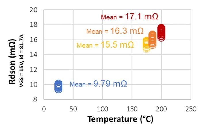

Compared with Wolfspeed’s 650 V, 15 mΩ MOSFET die with Tj rated to 175°C, the Gen 3+ product improves on RDS(ON) per unit area as well as total area to reach 10 mΩ. The 750 V rating improves the FIT rate and the MOSFET also elevates the Tj rating to above 175°C (200°C data shown) for peak condition operation during the vehicle mission profile. The temperature-stable RDS(ON) increases overall efficiency as well as system temperature limits (Figure 4).
Figure 4: The Gen 3+ 750 V MOSFET RDS(ON) (blue) remains low and stable over the 25°C-to-200°C range against the competition.

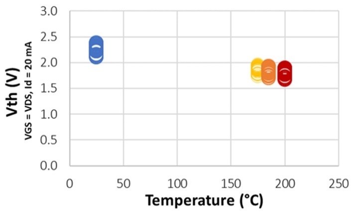

Figure 5: The new device offers a temperature-stable Vth (blue) for greater design freedom in avoiding spurious turn ONs.
Gen 3+ technology offers similar stability for the gate threshold voltage, Vth, giving designers enough headroom to switch aggressively while avoiding spurious turn-on (Figure 5). Combined with a high capacitance ratio, the stable Vth allows for safe operation without shoot-through concerns at elevated temperatures.

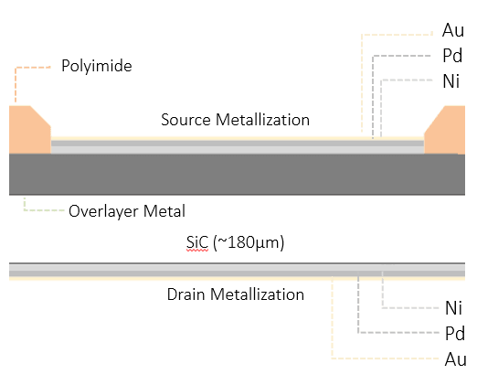

Moreover, Wolfspeed uses an Ni/Pd/Au metallization stack-up on both die sides to allow double-sided soldering/sintering. This new metallization used on Wolfspeed’s automotive die opens the option for more advanced packaging solutions that can lead to better performance from the die and better reliability of the package. Examples of this include sintering copper clips or films to the top of the die and using copper wire bonds for higher current carrying and thermal capabilities (Figure 6).
Close up illustration showing a double-sided metal stack-up and copper sintering. It labels what each part is made out of.
Figure 6: The double-sided Ni/Pd/Au plated metal stack-up double-sided copper soldering/sintering for higher current and thermal performance.
