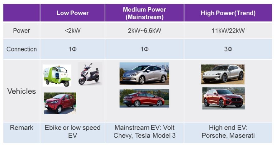

    Figure 1 shows typical uses for low-, medium-, and high-power OBCs. Low-power OBCs are popular for e-bikes and low-power EVs in India and China. Currently, the medium-power market (2~7.4 kW) is the most popular for many common battery EVs in Europe and the U.S. Medium-power OBCs use single-phase AC and charge EV batteries of about 400 V, but as demands for long range continue to increase, the market is trending toward 800 V batteries with higher-power three-phase OBCs of 11 kW and 22 kW; these offer faster charging times and lower currents for a given power level.
    A table with three header labels across the top row and four header labels down the first column. The first cell is intentionally left blank.  The first row header from left to right reads:  (header is intentionally left blank), Low Power, Medium Power (Mainstream), High Power (Trend). The first column has the following labels down:  (header is intentionally left blank), Power, Connection, Vehicles, Remark.
Second row of cells from left to right contains the following data in their cells:  less than 2kW, 2kW ~ 6.6kW, 11kW / 22kW.
Third row of cells from left to right: 1Φ (phi), 1Φ, 3Φ
Fourth row:  First cell is a group of three small images of small vehicles, a three wheeled delivery truck and a moped. Next cell contains images of two sedans. Third cell contains two luxury electric vehicles.
Fifth row of cells from left to right:  Ebike or low speed EV, Mainstream EV: Volt Chevy, Tesla Model 3, High end EV: Porsche, Maserati

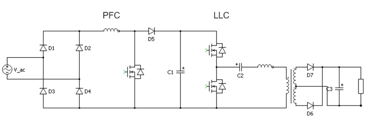

    At the lowest end of the market, silicon (Si) MOSFETs and diodes are preferred when cost is the highest priority, although they have disadvantages compared with SiC for high-power applications. Figure 2 shows a boost PFC and a half-bridge LLC converter; this combination is popular for low-power cost-sensitive OBC applications. Normally, this architecture supplies a relatively low voltage battery (<60 V) from a single-phase 120 V/240 VAC supply and can achieve peak system efficiencies of ~93%.

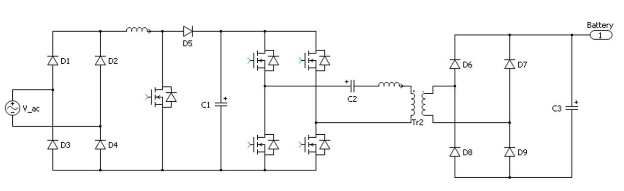

    For medium-power architectures, the designer can choose between cost-sensitive and high-efficiency options. The medium-power cost-sensitive design (Figure 3) uses the same PFC topology as before but replaces the half-bridge LLC DC/DC converter with a full-bridge design to support 400V battery. With a higher battery voltage, the power loss on the output rectifiers can be reduced. Hence, the efficiency is improved from that of the low-power OBC discussed above, with peak efficiency of ~94%.
    A circuit diagram; Si-based OBC architecture for medium-power cost-sensitive 3.3–7.4 kW
    Figure 3: Si-based OBC architecture for medium-power cost-sensitive 3.3–7.4 kW
    Si MOSFETs will still dominate in the active switch sockets in the low-cost design. The main opportunity for SiC in this low-cost design is the SiC diode in the PFC, D5 position in Figure 3. Zero-reverse-recovery current of the SiC diode enables SiC to replace the Si fast diode.

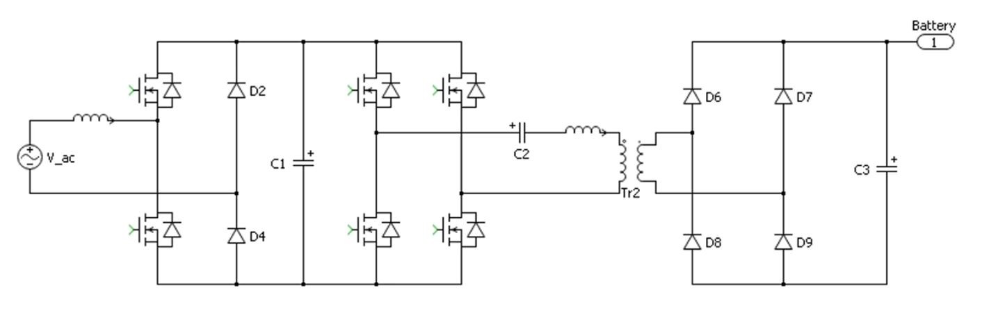

    The diode bridge in the conventional PFC wastes power, so the high-efficiency architecture replaces it with a totem-pole PFC. A totem-pole PFC improves efficiency by reducing the number of semiconductor devices in the conduction path from three to two. The totem-pole PFC has been the subject of much theoretical research, but Si MOSFETs limited its use to critical-conduction–mode (CRM) operation and low-power applications due to the commutation of the Si MOSFET body diode. SiC MOSFETs allow operation in continuous-conduction mode (CCM) for high efficiency, low EMI, and high power density. Totem-pole PFC is commonly accepted in high-efficiency design now, as shown in Figure 4.
    A circuit diagram; High-efficiency OBC architecture using SiC and a totem-pole PFC
    Figure 4: High-efficiency OBC architecture using SiC and a totem-pole PFC
    A high-efficiency medium-power design (Figure 4) can achieve peak AC/DC efficiency of >98.5%. The overall system peak efficiency is about 96%.
