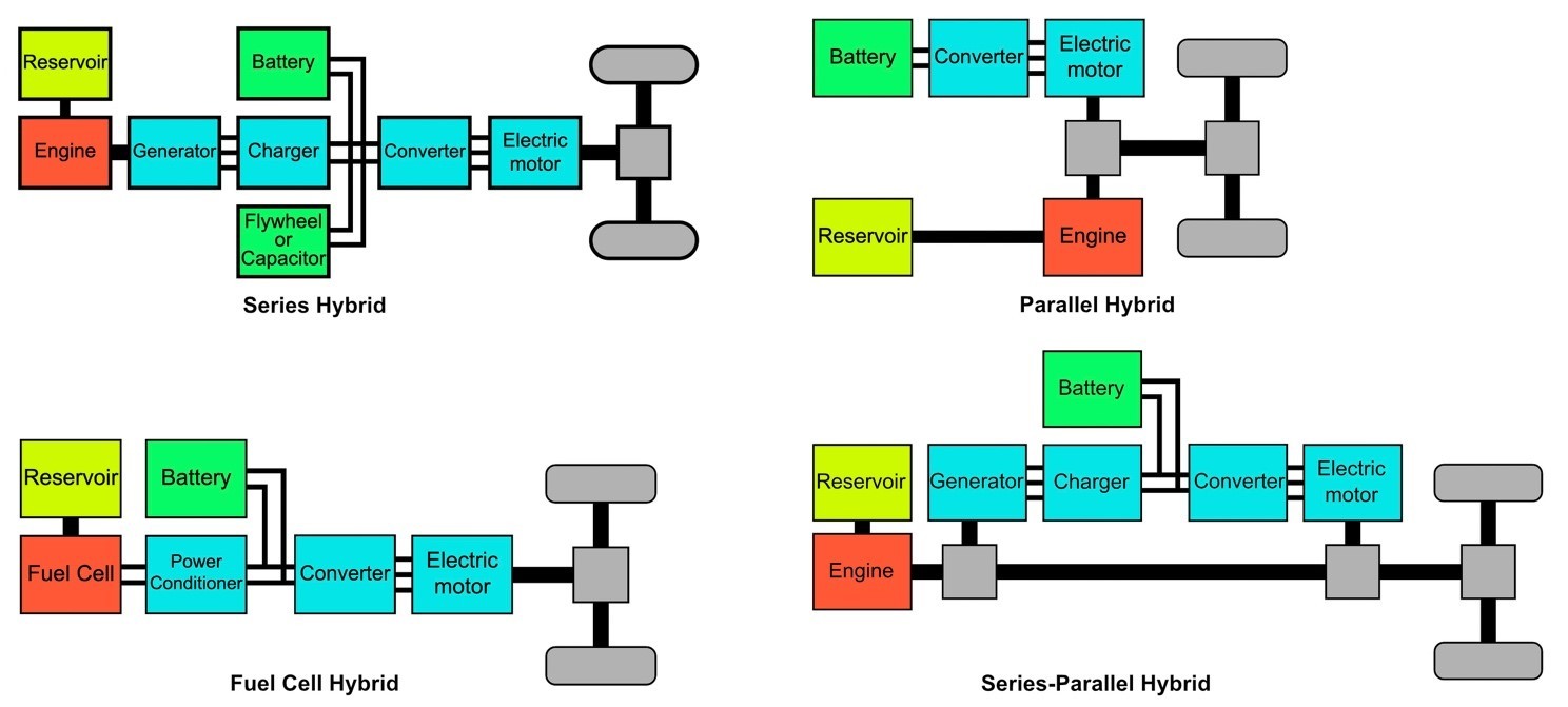

    Hybrid architectures
    Hybrid drivetrains have architectures similar to BEVs, except they have additional energy sources and smaller onboard electric energy storage. A common feature in all hybrid architectures, where Wolfspeed’s SiC modules shine, is the bidirectional inverter that allows the ICE and regenerative braking to charge the battery. There are, however, four major drivetrain arrangements (Figure 1), including series, parallel, fuel-cell, and series-parallel.
    The series hybrid, such as the Nissan ePower, Chevy Volt, BMW i3, and some models of the Toyota Prius, comprises an ICE that is in line with the battery and electric motor. The vehicle wheels and the ICE are thus mechanically “decoupled.” A significant portion of the design is that of a BEV with the motor driving the wheels directly. When the on-board battery is depleted, the ICE drives a generator that both charges the battery and powers the electric motor. Whenever a large amount of power is required, the motor draws electricity from both the battery and the generator.
    Four illustrated examples of architectures used in hybrid EVs..
    Figure 1: The various types of architectures used for hybrid EVs. Source: Illustrations by Peter Van den Bossche, Fred the Oyster, CC BY-SA 4.0
    On the one hand, the two energy conversions — mechanical to electrical to mechanical — result in higher losses,3 and on the other, the ICE size and speed can both be optimized for high efficiency. Both the battery pack and the motor in this architecture tend to be larger than in the parallel architecture, making it the more expensive hybrid.
    The fuel-cell HEV (FCHEV) uses a design similar to that of the series hybrid, except the ICE and generator are replaced by the fuel cell and a power conditioner that helps the fuel cell output the appropriate voltage and current for the application, in this case charge the battery or drive power to the inverter.
    The parallel hybrid architecture, as that found in the Ford Fusion, Honda Civic, and some models of the Toyota Prius, consists of the ICE in parallel to the electric drivetrain. The vehicle is propelled by both the ICE and the electric motor connected to a mechanical transmission that usually comprises a planetary gear system. The power distribution between the ICE and the motor is changed such that they both run in their optimum operating region as much as possible. When the electric motor does not supply rotational power, for instance, the ICE takes over.
    Because both the electric motor and, therefore, the inverter are smaller than those in the series architecture, parallel hybrids have lower costs.
    The power-split, or series-parallel, hybrid is a combination of both series and parallel architectures, with the intention of utilizing the benefits of both. Planetary gear systems are used to drive the shaft using both the ICE and the electric motor, and a generator to charge the battery is connected to the shaft as well.

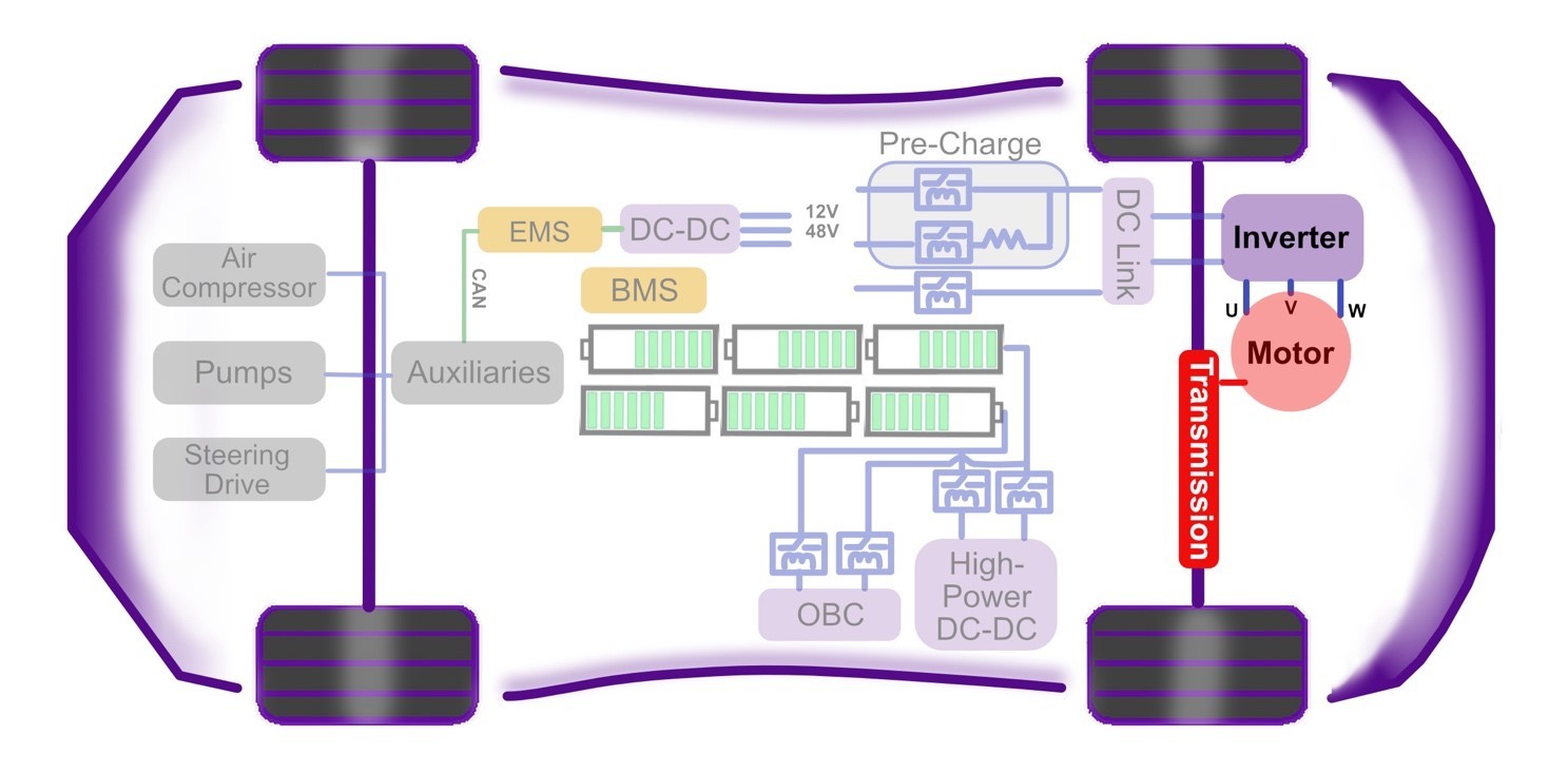

    All hybrid architectures, except FCHEVs, have been seen by many automakers as a transition to the simpler BEV drivetrain (Figure 2), with the battery, motor, and inverter being the main components involved in traction.
    Figure 2: Diagram of a typical BEV showing the traction inverter, motor, and transmission among other functional blocks

    BEV motors can be classified as hub motors and e-axles based on their mechanical coupling to the drivetrain. Hub motors are mounted at the wheel to drive it directly. The resulting removal of the axle and mechanical gears offers benefits of higher efficiency, smaller motors and inverters, and lower interior floors.
    However, hub motors require special control to tune the speed of each wheel to changing requirements, such as when turning the EV needs outer wheels to rotate faster than the inner wheels. Because a differential pumpkin is not available in axle-less designs, the rotational speed differential must be handled by electronic motor control. With an inverter driving and controlling each motor, this design can get expensive. Another challenge is environmental protection from dust, debris, and water, which may require integrating and sealing off all electronics with the motor.
    Suppliers of hub motors are fewer, including Protean, Elaphe, and Nidec, compared with those offering e-axles.
    Mounting the motor in the center of the axle results in the e-axle design. While this usually requires only one motor per axle, there can be variations. Tesla’s Tri-Motor, for instance, uses two motors on one of the axles.
    Although the e-axle usually requires motors to be larger because they drive the full axle, it is cheaper and therefore more popular. It has fewer electronic components because some of the speed control requirements are replaced by cheaper mechanical parts.

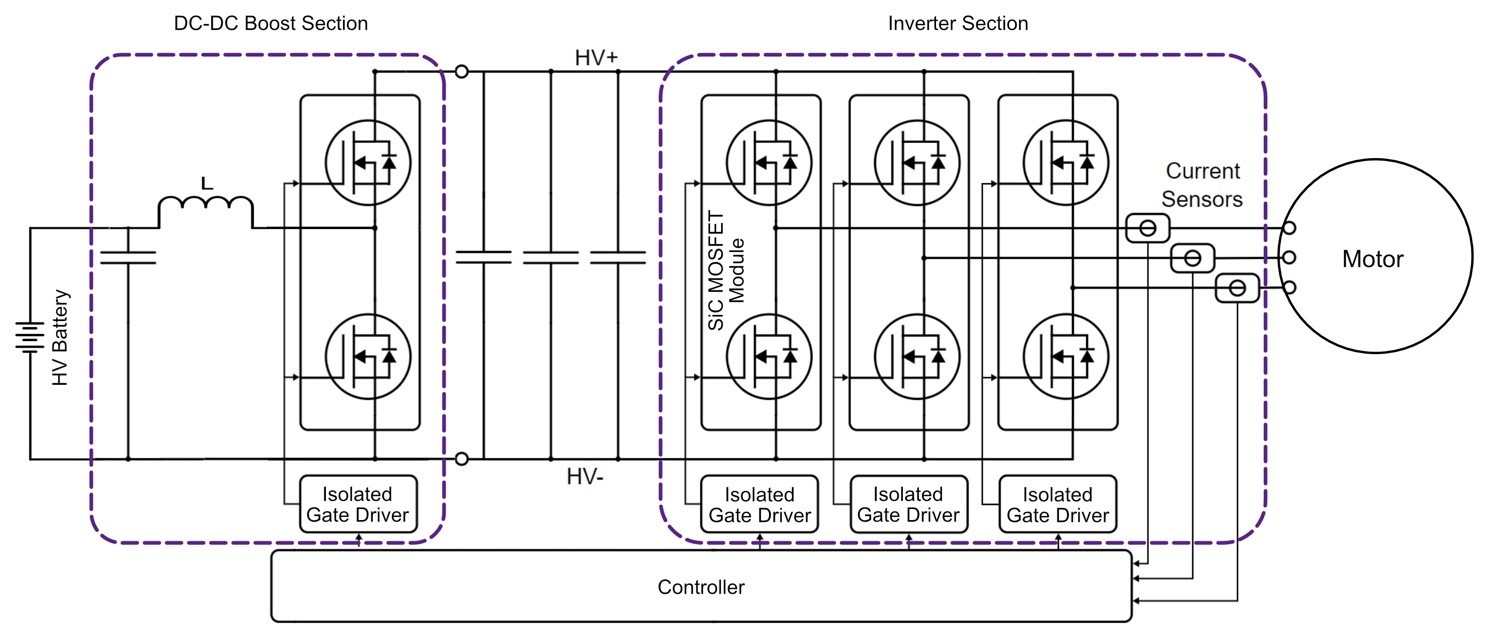

    Traction inverters
    The traction inverter converts the high-voltage DC from the battery to the three-phase AC needed by the motor (Figure 3). However, not all designs use the boost converter shown in the figure.
    Circuit diagram of a 3-phase traction inverter.  This diagram uses 3 half-bridge Silicon Carbide MOSFETs.
    Figure 3: The 3-phase traction inverter using three SiC MOSFET-based half-bridge modules. The DC-DC boost converter, also implemented with SiC MOSFET modules, is not always needed.
    Bidirectional inverters needed for regenerative braking are best implemented with SiC power modules because they allow for higher efficiency, greater power density, and simpler circuits compared with silicon IGBT components.
    The inverter is usually required to output square waves with switching frequencies between 6 kHz and 24 kHz. This output is filtered by the motor’s inherent inductance to provide a fundamental electrical frequency, which is also the shaft rotational speed for synchronous motors.

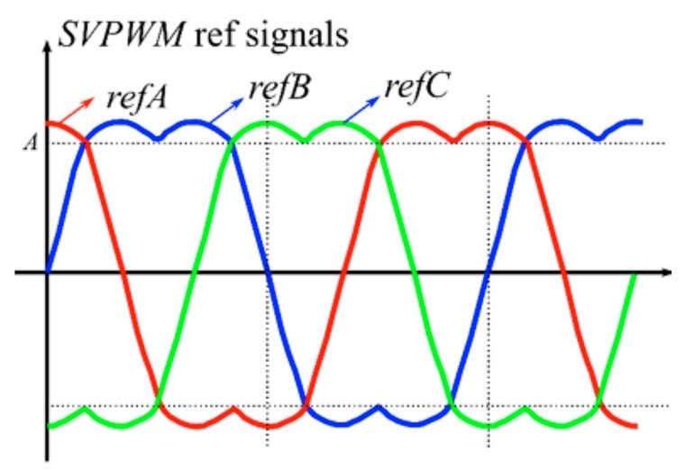

    Although the classic pulse-width–modulation (PWM) scheme is used by most modern microcontrollers and is easy to implement for motor control, it is not common in traction inverters because it is not the most efficient switching scheme. Instead, the space-vector PWM (SV-PWM) is used in BEV applications. It allows overmodulation for attenuating the top of the sine waves so that a voltage higher than the DC-link bus voltage can be applied and greater current driven through the motor (Figure 4). This scheme also minimizes the switching transitions in the six switches of the inverter, thereby lowering switching losses and increasing efficiency.
    A graph of SV-PWM waveforms
    Figure 4: The three-phase SV-PWM waveforms
