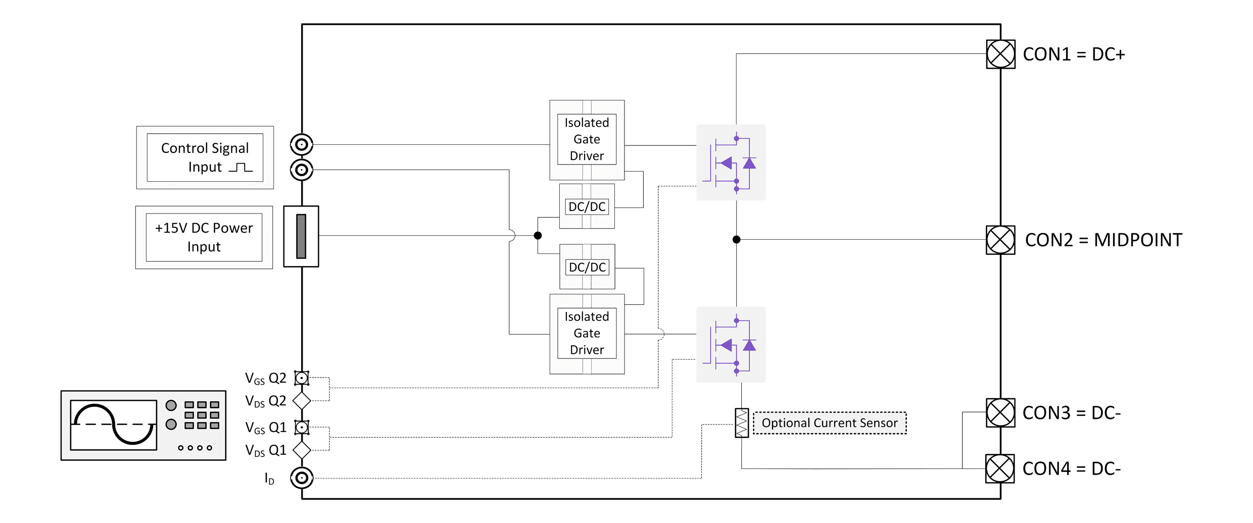

    This evaluation board demonstrates the switching and thermal performance of 650V Silicon Carbide (SiC) C3M™ MOSFET in a 7-pin D2PAK (TO-263-7L) configured in a half bridge topology. The board is designed for characterizing EON and EOFF losses and steady state thermal performance in Silicon Carbide MOSFETs. The PCB contains AlN inserts under the MOSFETs to provide electrical isolation and optimized heat transfer to the heat sink. This design :
    • Demonstrates use of an AlN inlay PCB for thermal management of surface mount power devices
    • Serves as a PCB layout example for driving D2PAK SiC MOSFETs
    • Max DC Bus Voltage of 450V
    • Max Power of 4.2kW @ 100kHz
    • Optimized locations for scope probe measurements of drain current; VGS; and Vds
    • Predrilled thermocouple locations in the heat sink under the MOSFET
    • Synchronous and asynchronous buck and boost topologies supported
    • Kit includes two SMA and BNC adapters for measuring VGS waveforms
    • Includes heatsink; fan; fan guard; and thermal pads
    • Can be configured as full bridge DC/DC by using two evaluation boards

    kit crd 8ff65p block diagram bg

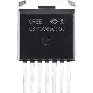

    C3M0060065J
    650V Silicon Carbide C3M™ MOSFET in 7-pin D2PAK provides low parasitic inductances for faster switching in power conversion applications
    C3M0060065J
