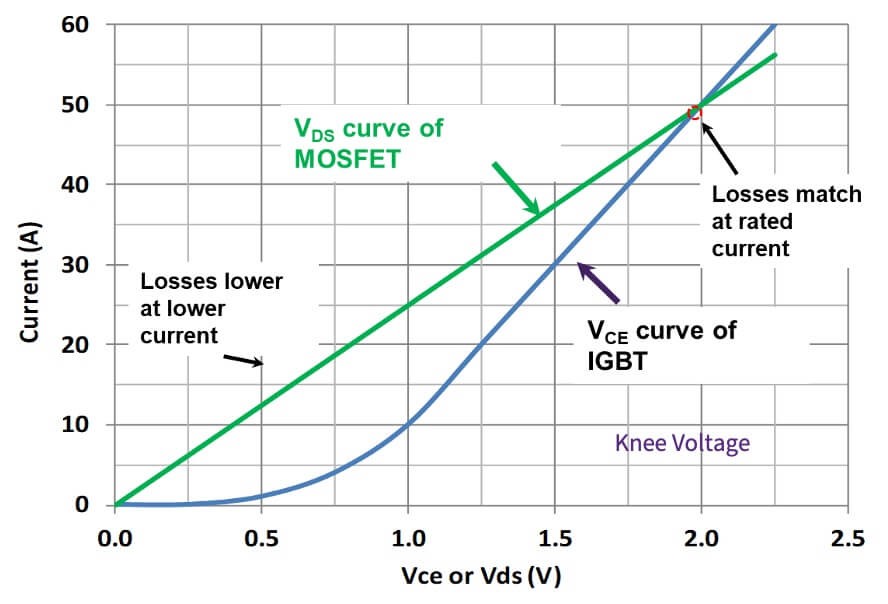

    Below, Fig.1 and Fig.2 show the comparison of conduction loss and switching loss of a typical 1200 V SiC MOSFET and a 1200V IGBT with same rated current. Under lower loads the SiC MOSFET conduction losses are as much as one-half that of the IGBT and offers up to 90% less switching losses than the IGBT by eliminating the turn off tail current.
    Line chart depicting conduction loss for 1200 V SiC MOSFET vs IGBT
    Fig.1 Conduction Loss, 1200V SiC MOSFET vs IGBT

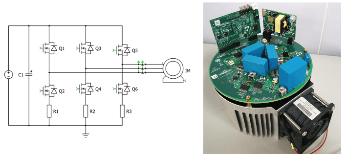

    Shown in Fig.3, Wolfspeed’s newly released 11 kW High-Efficiency Three-Phase Motor Drive Inverter (CRD-11DA12N-K) was designed to test Wolfspeed’s 1200 V SiC MOSFETS in industrial heating and cooling applications. This design accomplishes peak efficiencies of 99% and a full load efficiency of 98.6%; wide operating voltage range of 550-850 VDC and closed loop sensorless field oriented control. The test results are shown in Fig.4 and Fig.5.
    There are two different images. On the left is a block diagram of the 11 kW Three-Phase Motor Drive Inverter with 1200 V. On the right, the physical product of SKU C3M0075120K.
    Fig.3, 11 kW Three-Phase Motor Drive Inverter with 1200 V SiC MOSFET (C3M0075120K)

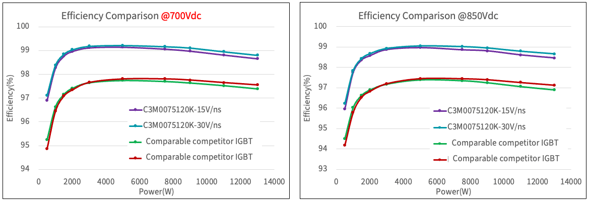

    There are two line graphs showing the two efficiency comparison at 16 kHZ: on the left it's at at 700 V ds.  On the right, it's at 850 V dc.
    Fig.4, Efficiency Comparison @16kHz

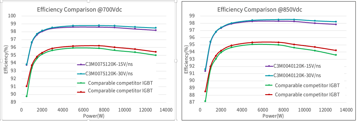

    There are two line graphs showing the two efficiency comparison at 32 kHZ: on the left it's at at 700 V ds.  On the right, it's at 850 V dc.
    Fig.5, Efficiency Comparison @32kHz
    As shown above, by replacing silicon IGBTs with silicon carbide, running at 16kHz, motor drive efficiency can be improved by >1.2%, a >50% reduction in power losses. As IGBT device efficiency drops under high operating frequency, silicon carbide devices can easily double the operating frequency from 16 kHz to 32 kHz to help shrink the sizes of passive components, while maintaining >98% efficiency.

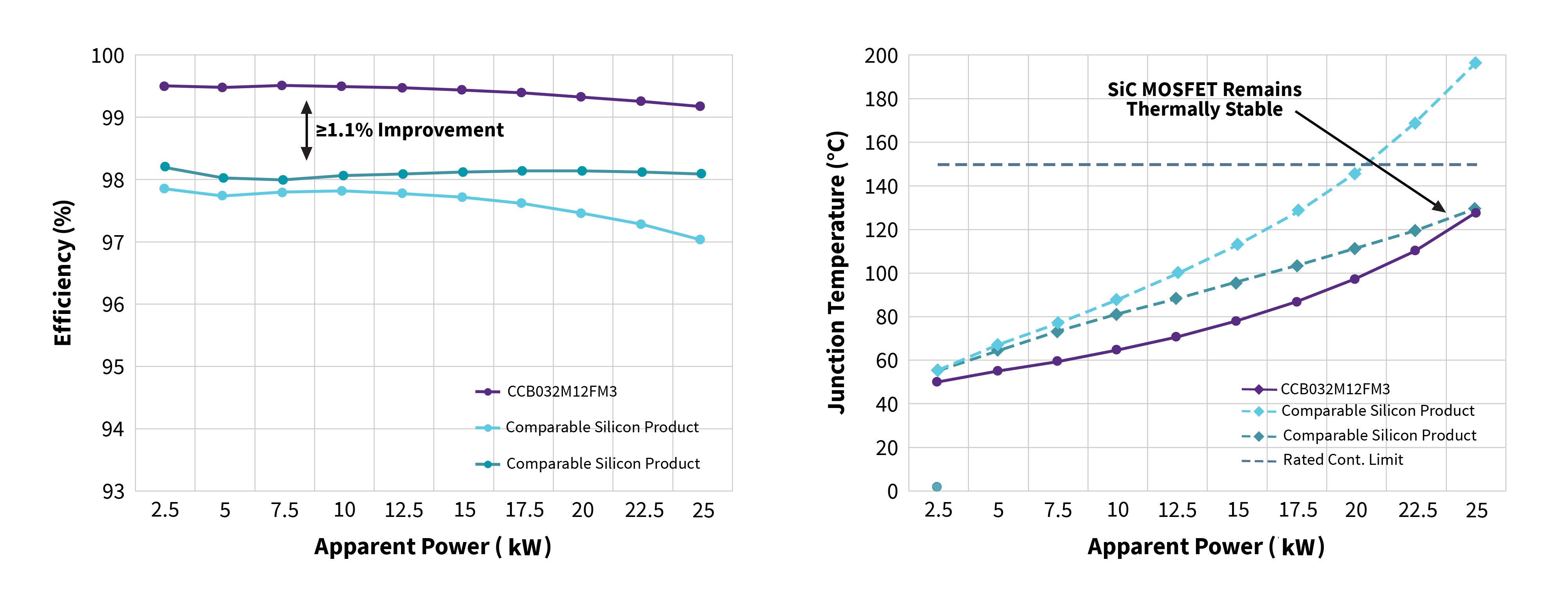

    Two line chart side by side: the left-side chart measures efficiency (%) with increasing apparent power (kW).  CCB032M12FM3 is shown to have at least a 1.1% improvement over two comparable other silicon products. The right-side chart measures junction temperature with increasing apparent power (kW). CCB032M12FM3 is shown to remain more thermally stable than two other silicon products.
    Fig. 6: 25 kW inverter, Fsw = 8 kHz, larger Si IGBT heat sink: 1.37 L (0.7°C/W), smaller SiC heat sink 0.8 L (0.99°C/W)
    Results in the graphs above have been achieved with a 77% smaller heat sink for the silicon carbide inverter as compared to IGBT. Despite a much bigger heat-sink for Si modules, the 50 A IGBT module’s junction temperature is still significantly above the 150°C temperature limit, but the 32 A SiC module and the 100 A IGBT module end up at the same junction temperature of around 129°C. Also noteworthy is that efficiency in the silicon carbide inverter increases by 1.1%. Additionally, the efficiency improvement above is not only at peak loads but also at partial loads. At some partial loads the efficiency improvement is higher which is ideally suited to the typical load profiles of data center cooling systems.
