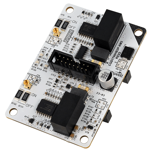

    CGD1700HB2P-XM3
    Wolfspeed’s CGD1700HB2P-XM3 is a form-factor-fitting; two-channel gate driver for the 1700 V XM3 module platform with cross gate pins. Each of the two gate drive channels features over-current protection, an active Miller clamp, and separate turn-on and turn-off gate resistors for effortlessly tuning switching speeds. Onboard 2 W isolated power supplies support up to 80 kHz switching frequency. The gate driver board features MMCX connectors to accurately measure high-side and low-side VGS with fiber optically isolated probes such as the TIVP1 from Tektronix®.
    • Fully Assembled Gate Driver PCB
    • Reference Design Files
    XM3 Half-Bridge Power Module Products Supported:
    • CAB320M17XM3
    Sold Separately
    • Differential Transceiver CGD12HB00D
    • Evaluation Tool KIT-CRD-CIL17N-XM
