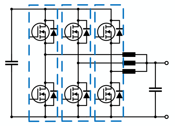

Medium power DC/DC converters are necessary in a myriad of applications, including EV charging, solar energy transfer/storage, and power supplies. A multi-phase interleaved, bidirectional DC-to-DC converter, for instance, can be achieved by connecting an arbitrary number of power phase legs in parallel to scale the maximum output current/power capability while reducing current ripple (Figure 3). The gate signals for the switches of a three-phase interleaved DC/DC converter are phase shifted by 120° for the cancellation of low-frequency harmonics. An interleaving can be achieved with only minor alterations to the controller and thermal system. The output power can reach 60+ kilowatts and still be well below the maximum junction temperature of the SiC die, allowing for the system to function reliably over its operational lifetime. Interleaving is a good strategy to avoid some of the challenges of paralleling devices, while also improving system performance and reducing output inductor size.
Figure 3: Schematic representation of basic interleaved DC/DC converter.
Figure 2: Schematic representation of basic interleaved DC/DC converter.
This same interleaving methodology can be applied to a variety of converter and inverter architectures to reliably scale up power without sacrificing electrical and thermal performance. Coupled with the benefits of SiC technology and the simplified thermal management of the baseplate-less Wolfspeed WolfPACK family, deployment of converter families with a wide output power range has never been easier!

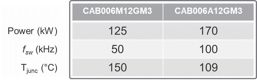

The typical go-to ceramic substrate for Wolfspeed WolfPACK family is aluminum oxide (Al2O3) as it provides a very nice cost-performance trade-off that suits this baseplateless module family well. However, customers understand that aluminum nitride (AlN) can offer large performance impacts with a relatively low-cost increase. With 7× higher thermal conductivity compared to Al2O3, the impacts can easily be understood: reduces thermal resistance, lowers Tj for given loss, enhances PC lifetime for given losses, enables higher utilization of SiC performance.
This is once again demonstrated by considering a 2-level grid-tied inverter operating at an 800 VDC bus voltage, 480 VAC line-to-line RMS grid voltage, an ambient temperature of Tamb = 50 °C, and line inductors of L = 100 µH. Like the previous scalability study, utilizing an AlN substrate for the 6 mΩ GM3 creates the ability to scale across the three variables: power, switching frequency, and junction temperature. This enables solutions for customers who need more usable ampacity, or in some use cases, reduce the operating junction temperature to enhance lifetime, or to enable higher heatsink temperature (cost reduction).
Figure 8 . Comparative study results demonstrating the scalability of the GM3
Figure 7 . Comparative study results demonstrating the scalability of the GM3
